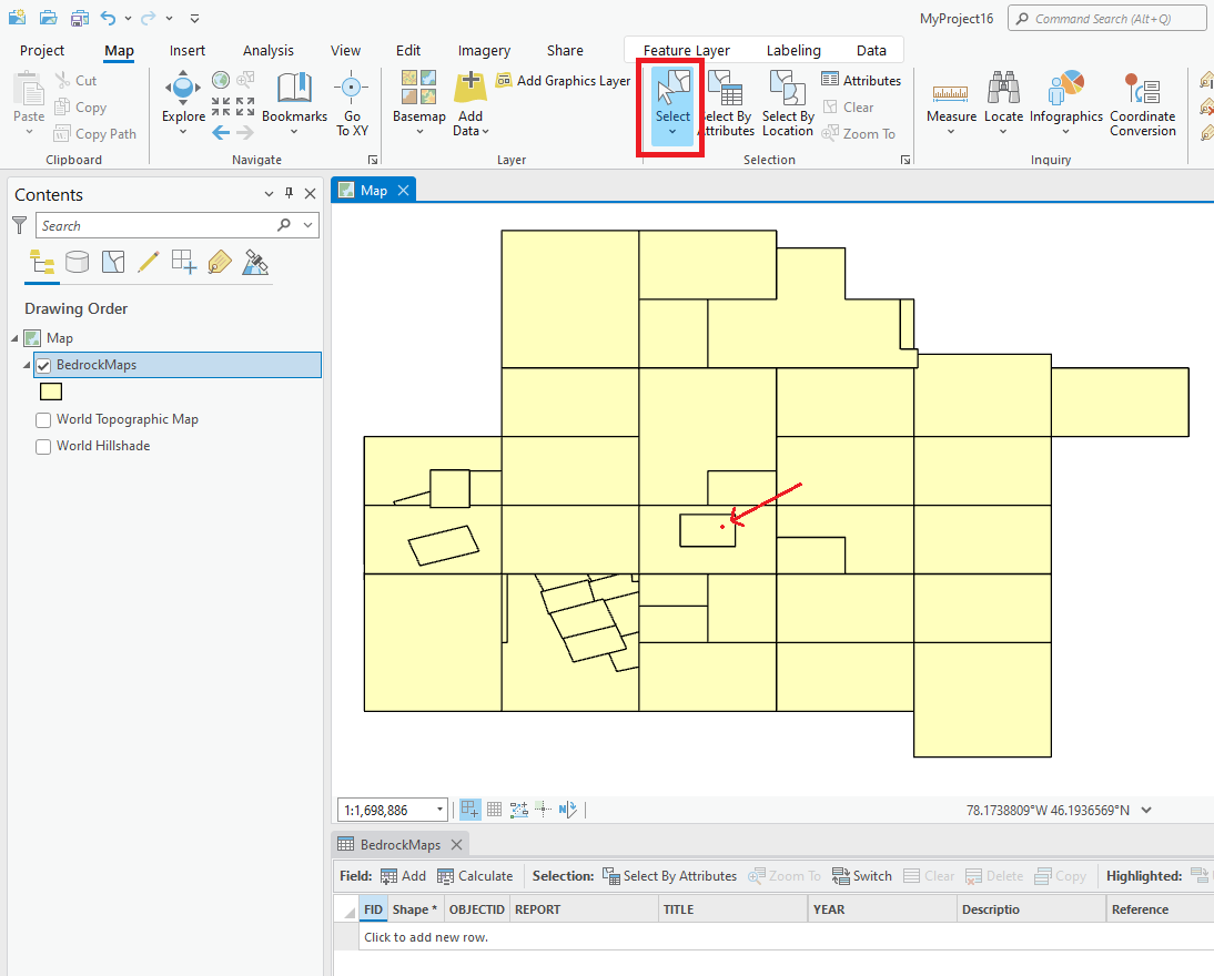

I have a shapefile that has overlapping polygons. I've used the Select tool to try to select all the polygons at a specific location -- at the red dot in the screenshot below:

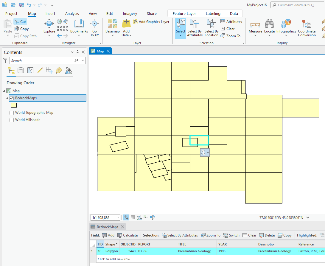

I've single-clicked at that location, which has selected a single polygon:
It seems like ArcGIS Pro is behaving differently than ArcMap did.
  • ArcGIS Pro selects just a single polygon, even if there are multiple overlapping polygons at that location.

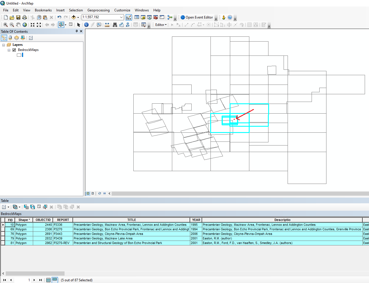

  • Whereas ArcMap would have selected all of the polygons at that location when doing a single-click selection:
As a new ArcGIS Pro user, that difference in selection behavior threw me off a bit. I didn't understand why all the polygons at that location weren't being selected.
Further, I would have thought that the top-most polygon would have been the one that got selected. But it doesn't seem to work that way; a polygon that is lower in the stack has been selected.
Question:
What logic is used for single-click selections when there are multiple overlapping features? How does ArcGIS Pro determine what single feature to select?

I would assume objectid in ascending order? Click overlapping objectids 3, 5, and 6, 3 will get selected first. That's how it seems to behave for me in some simple tests.
But display order, I believe that is objectid descending. So those same overlapping shapes will show 6 at the top of the stack.
AGOL lets you define feature display order, but I don't think that is in Pro as of yet.
- Josh Carlson
Kendall County GIS
BarryNorthey
ArcGIS Pro displays a chip to signal that there are overlapping features at the click point, which might not be obvious when using Single Symbol symbology. The chip provides the user with the ability to select/flash any intersected feature including the "top one". The chip's pick list honors the layer's Display Field, which can also be an expression to help with feature selection/identification. To select all the intersected features, ignore the chip and drag a "tiny" shape at the same click point.
