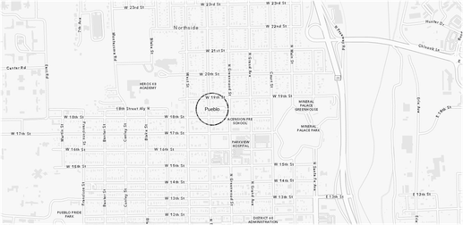

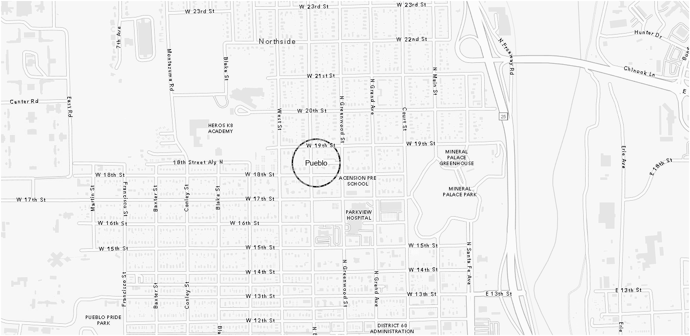

I have this polygon layer  and the labels are turn on; however, I am trying to use the simple line but I am not seeing it . I don't know why or for some reasaon unknown.
Is there something I do wrong ?
Here you can see Pueblo with a circle , it is a polgyon and the label is on .

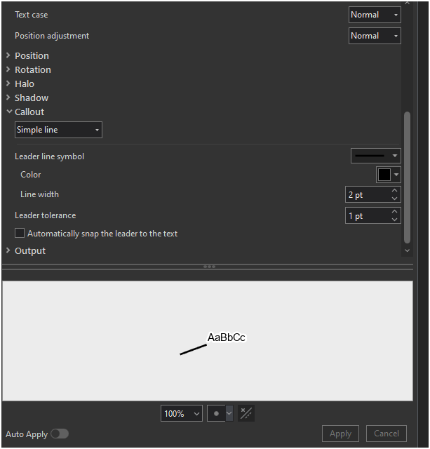

Check out my settings for that Label
You can see the simple line above but the label in the Map does not show ?

Never mind. I got it to work !
In order to show the simple line to show you, you need to go over to the Postion in the Label Class
then at the first  tab  Postion then use the Regular Placement and then use the Horzional around polygon.
Need to set what number you want in Preferred offset and Maximum offset.
You can experiment what numbers you want and choose which measured you want.
