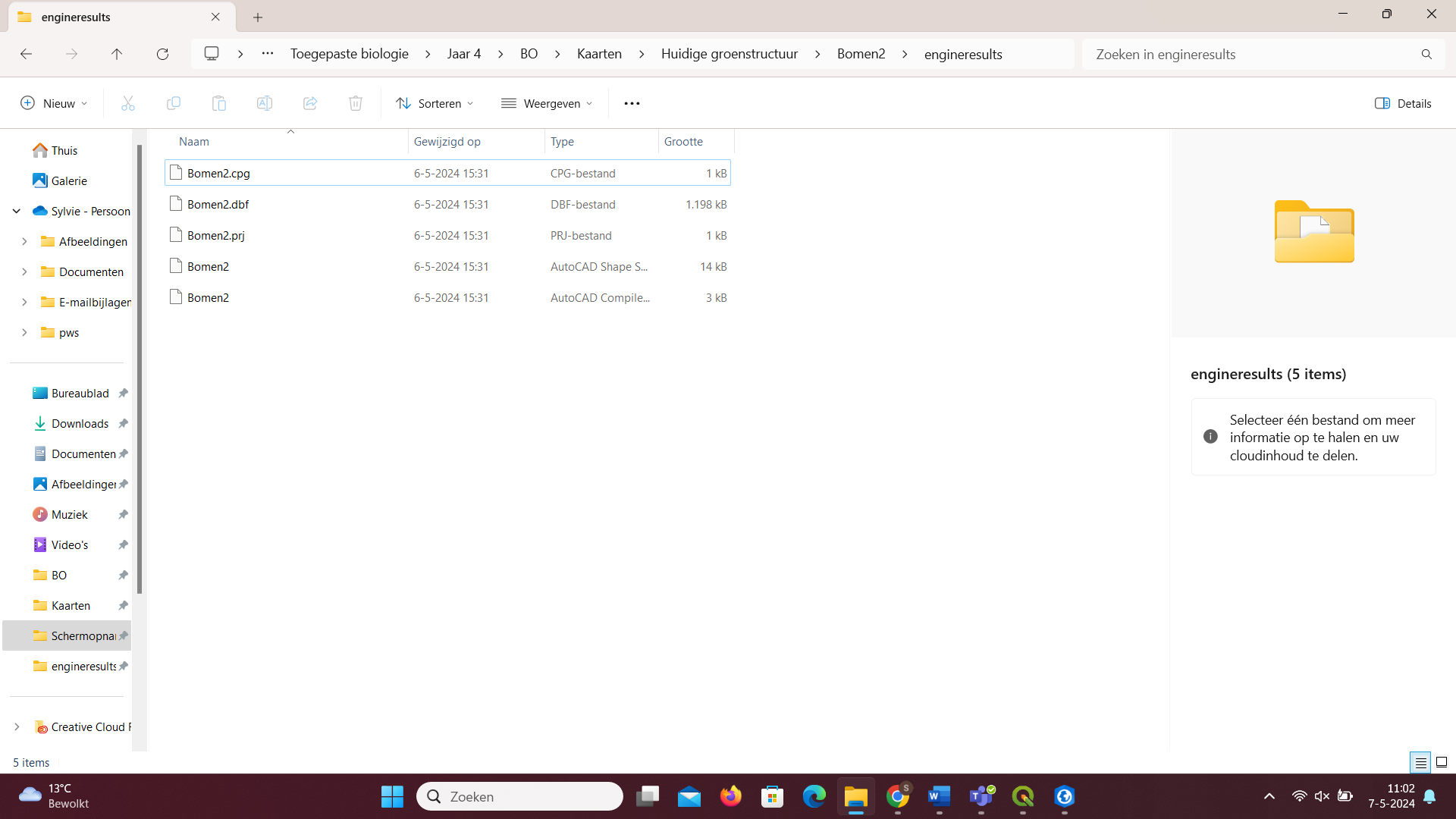

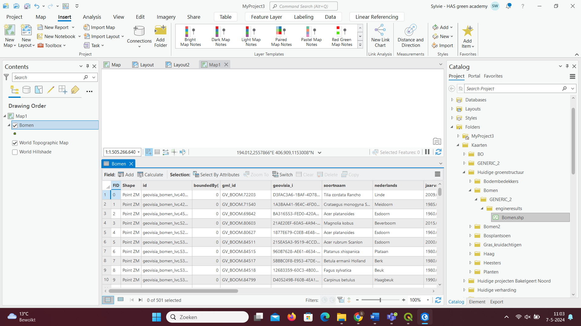

Hello, I have a shapefile I have exported from a different geo information application. I want the data to show in arc gis pro but it does not show. It does in Qgis.
The data looks like this.

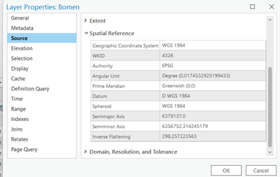

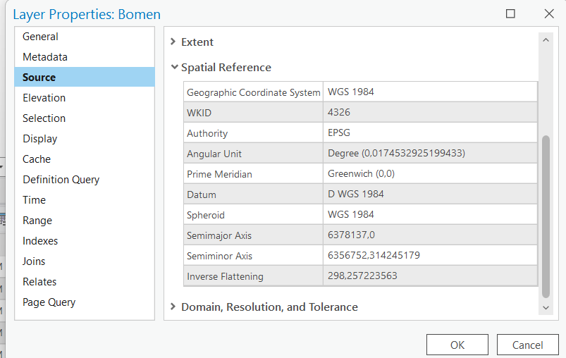

the attributes look like this
I was thinking it maybe was the coordinates but its not the problem
Can anyone tell me why it is not working?

I'm interested in what the other two Bomen file extensions are. You have a .cpg, .dbf and .prj files but for a fully functioning shapefile you need to have additional .shp and  .shx  files.
This oldish document will show you all the valid file extensions:
Shapefile file extensions—ArcMap | Documentation (arcgis.com)
That would be my starting point....
I hope this helps
