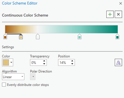

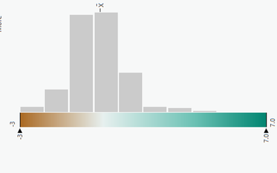

When using "Unclassed Colors" as the primary symbology of a raster layer in ArcGIS Pro, is it possible to set an exact value for the midpoint? It appears as if you can only specify the min and max values:
I want to achieve a divergent color ramp that centers on 0. The best I can do is play around with the colors of the actual color ramp, but this is not exactly scientific and does not achieve the precision I am after.

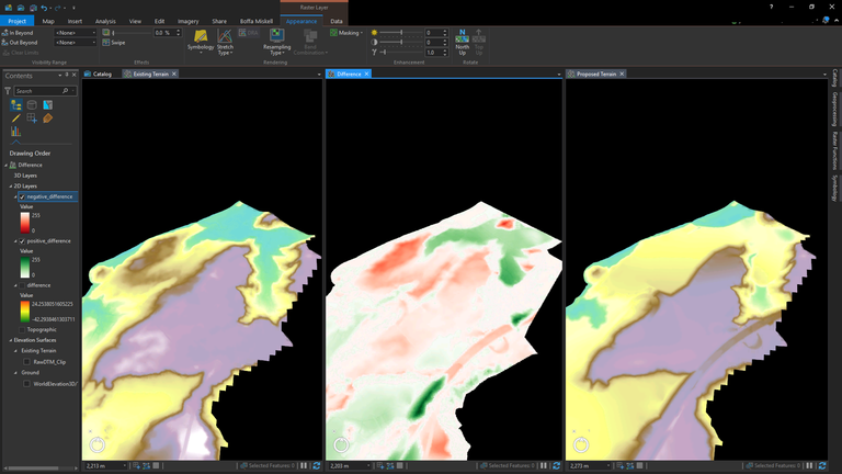

Hi. Try the Stretch raster function -  Analysis tab>Raster Functions>Appearance>Stretch. Has the advantage of being fast and not changing or creating datasets, meaning you can safely experiment a bit. Did something similar when wanting to use red/green ramps to show negative/positive difference between two DEMs.

My example is a bit of a bodge, but provided a way to put the middle of the divergent ramp exactly at the value I wanted.  The bodge is that I split my raster into two layers with different MinMax values using Stretch raster function (and messing with the statistics), and then symbolized with two monochrome red/green ramps ending/starting with white. And then specifying max/min value as transparent in the Mask tab.  Works but not elegant.
