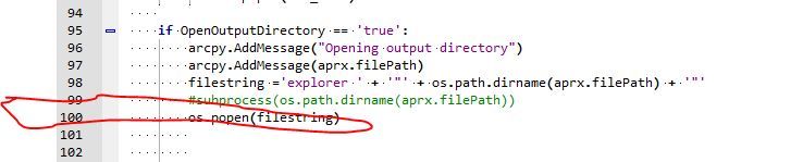

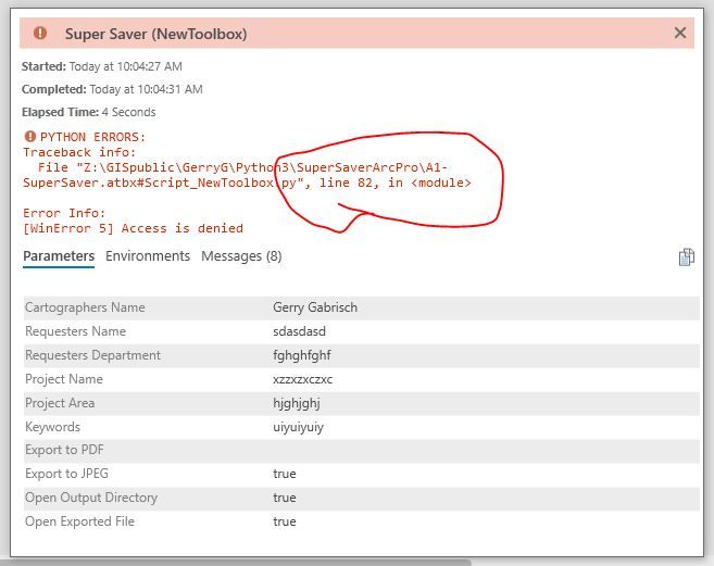

I am porting a scripting tool to Pro v3.  The error messages returned by my scripting tool return a line where the code failed but this line number is not the same as the line number in my Python IDE where I am writing the code.
Here is the error message returned from the ArcToolbox scripting tool:
Here is where the code failed (although I have the code sorted out now).
My question is why is the scripting tool error message not returning the same line as the Python code? How is it possible to debug scripts in Pro if you cannot determine the correct line of code that is failing?

hard to say, but what is in the vicinity of line 82 and what are the 8 messages that were reported? (eg did it report your line 96 and 97?  Also, how many lines of comments/ blank lines do you have (they may be stripped by the tool  when it makes the temporary script)

Other messages?  I have arcpy.AddMessage sprinkled around in my script to  provide feedback.  Blank lines not counting?  That is just wrong if that is the case.  Hopefully someone from the ESRI team can confirm that.
