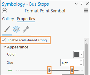

Hi Maureen, you can apply scale-based sizing to all the symbols in a layer. The option is on the Symbology pane, under Format Point Symbol, on the Properties tab. Described in the help topic Scale-based symbol sizing

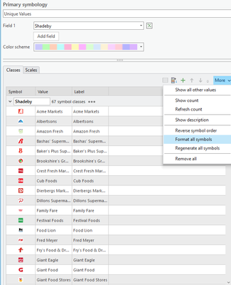

I also meant to include 2 screenshots.  I was hoping to enable scale-based symbol sizing by selecting Format all symbols form the symbology tab:
But enable scale-based sizing is not an option.  Is there a reason why that functionality is not available for all symbols?  Thanks.
