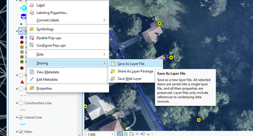

tmichael_wpjwa
This can be accomplished through the Sharing menu when you right-click on a layer in ArcGIS Pro:
