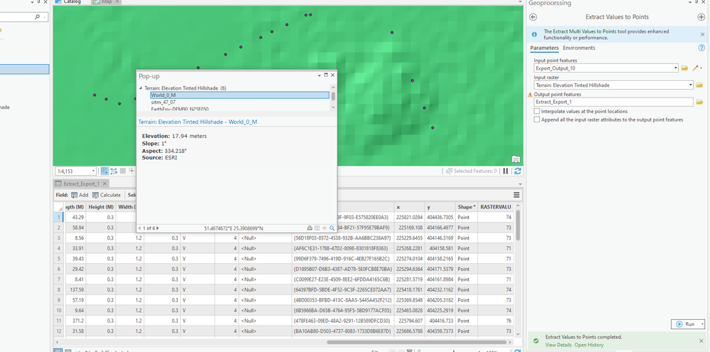

I'm trying to extract elevation from Terrain: Elevation Tinted Hillshade but i get this results 75 , but no elevation what's the problem and how can i resolve it pleas

A hillshade Terrain should not be used for extracting elevation values to a point feature class. You would use the default Terrain 3D or Terrain. Please see this topic on considerations for using the Terrain 3D elevation service as input to geoprocessing tools.
https://pro.arcgis.com/en/pro-app/latest/help/mapping/layer-properties/use-elevation-source-layers-i...
