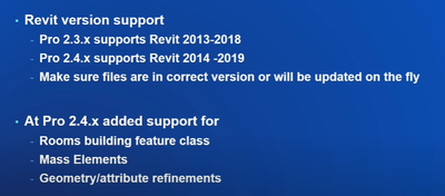

You may have to check which versions of Pro supports which version of Revit. For example,
Pro 2.4 supports Revit 2014-2019.  You can also check the below video

Thank you so much. I'm using Revit 2020 so that might be the problem. Do you think that another problem could be the fact that i'm trying to insert a .RVT file that is the "master file", so that is linked to other .RVT files relative to other disciplines? Because it doesn't allows me to change the coordinates in the sub-files, only in the master one.
