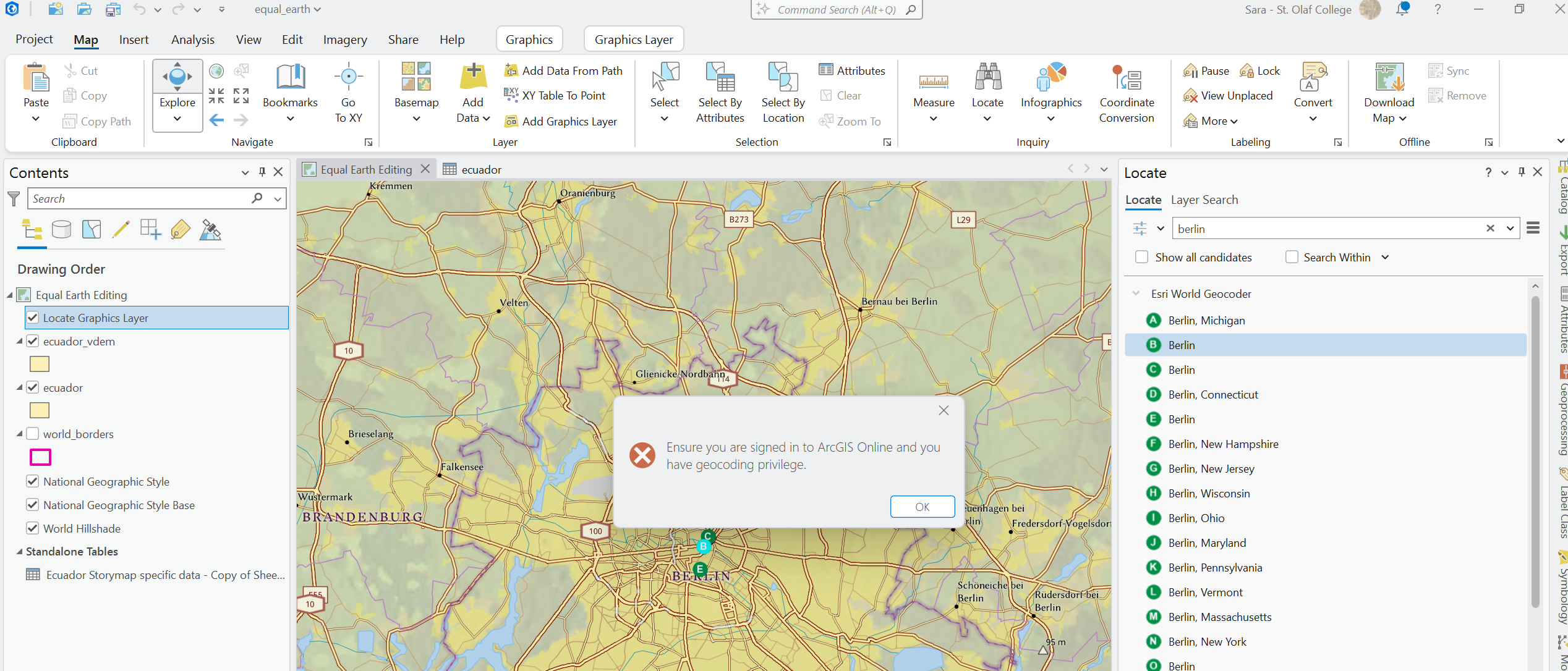

I'm running into an issue that I'm having trouble with - users have all the permissions, have a Professional Plus license, but are encountering a variety of permission error messages when trying to do a variety of tasks. It works for some people and not others.
They are working on this tutorial - but we can also replicate the issue without going through tutorials.
(I have the user clipped out for privacy reasons - but their profile does appear on the top right)
SaraJL_0-1767897480621.pngSo far, we have encountered this when using the Geocoder - but someone also reported it when they were just trying to add a picture to ArcGIS Pro.
Any thoughts? We only use SAML authentication and are on ArcGIS Pro 3.6.1
Thank you!
Update - I was finally able to replicate this on my own account!
Locate > search for a place > click on any result > Add Graphic
I'm a full admin, so I'm not sure why I'm receiving a permissions error.

One thing to try is verify you have geocoding privileges enabled:
1. Sign into ArcGIS Online as the admin
2.  Navigate to Organization>Settings>Member Roles
3.  Ensure the role assigned to the account has Geocoding enabled under Premium Content.
4. Allocate credits for geocoding.  Organization>Members, search for the member/role, click the 3 dots to the right of the member/role and allocate credits to the account under Manage>Credits.  Save
5.  Ensure that the ArcGIS World Geocoding service is configured.  Organization>Settings>Utility Services
Hope this helps!
SaraJL
All of those things are enabled and I am also the admin!
I don't limit anyone on credits so there isn't a cap assigned to any users in the organization.
Robert_LeClair
Esri Esteemed Contributor
Okay - thank you for the feedback.  I'm running ArcGIS Pro 3.6.1, am connected to an ArcGIS Online portal, am an administrator, configured for geocoding and have no problem searching for a location and adding as a graphic.  To be fair, whenever I do a major release upgrade of say 3.5 to 3.6, I do a clean uninstall/reinstall versus an in-app upgrade.  One thing to try is a How To: Perform an ArcGIS pro Soft Reset - sometimes this fixes wonky issues.  If not, we'll continue to troubleshoot.

I just tried the reset - unforunately, I'm still getting the error message. I'll keep testing some other things in case I learn something else.

Just wanted to give you a quick update - I did some troubleshooting with ESRI Tech Support on Friday - it looks like the geocoding issue is also effecting our ArcGIS Online accounts. But I'm working with Tech Support to try and resolve it!
We haven't found a solution yet, but I'll be testing a downgrade of ArcGIS Pro today to see if that may address it.
