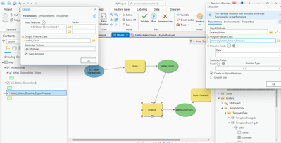

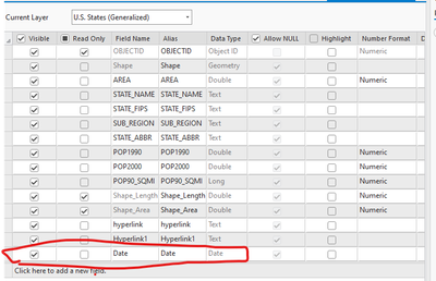

@DianaKing001 I couldn't reproduce this on my end. Which version of ArcGIS Pro you're using?
I used ArcGIS Pro 3.2.0. Either way, union & dissolve as in memory or in gdb, I couldn't reproduce this issue.
My workflow is:
Input Layer:
Output Layer:

GeeteshSingh07
My workflow is:
Input Layer:
Output Layer:
