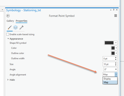

How to control if marker symbols are rotated together with the map ?
Below i gave 60° rotation to my map. The "P" symbol rotated too, which i don't want.

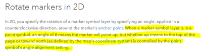

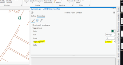

You can choose whether the symbol rotates with the map, or stays fixed with the display in the Symbology settings for the marker symbol.

Yes, thank you
