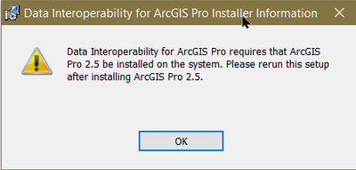

Hello, in order to perform an exercise for my student course, I need to install the Data Interoperability extension.  Unfortunately, I am currently using 2.6.2 and the extension provided by my professor works only with 2.5.  Below is the popup I am receiving.
I do have the .exe files from my professor.
How can I roll back to 2.5 without uninstalling/reinstalling?
Thanks so much.
MehdiPira1
@LeahLobsiger
No, you cannot rollback or downgrade ArcGIS Pro without uninstalling/reinstalling.
