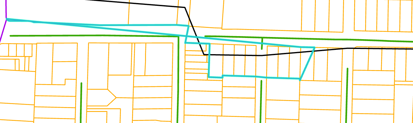

I'm creating a new feature in a  dataset and I misclick then the feature locks (for lack of better use of a word).
1)
This is the vertex that I drew last where I want to continue editing from

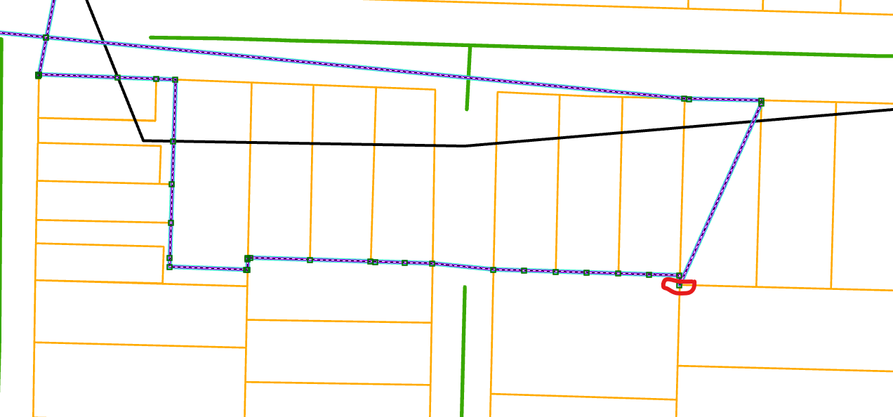

2)

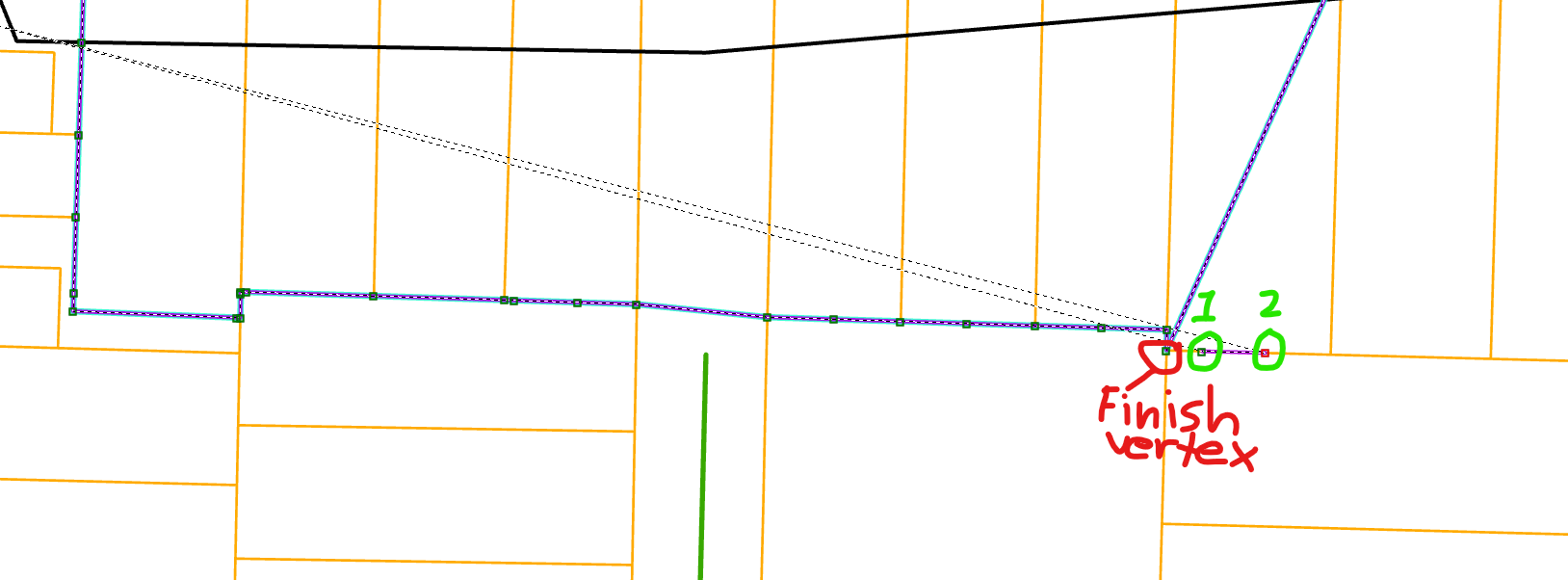

To begin editing again I use the Continue Feature option and I used to be able to trace along the line for 1 or 2 vertices then delete those vertices and the last vertex (finish vertex) would become active to continue drawing my feature. See screen shot below.

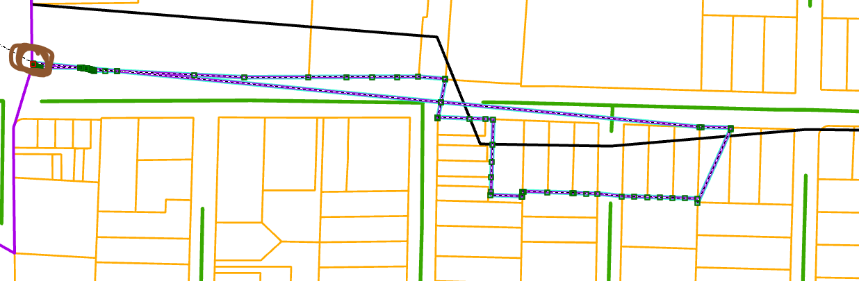

When I do that however a vertex at the beginning of the polygon feature engages though. See vertex circled in brown below.

2) Click and draw a single vertex some where, which indeed draws a new part, BUT when you delete that single new vertex the polygon should start to let you continue editing from the last vertex that was drawn before the feature was locked. This is what I am trying to show in the 2nd and 3rd images in my original post.

The unexpected behavior is doing steps 1 and 2 of the expected behavior described above, BUT this time the vertex that it allows me to continue drawing from is the vertex from image 4 of my original post, which doesn't make any sense because it was one of the first vertices where I started my polygon.
