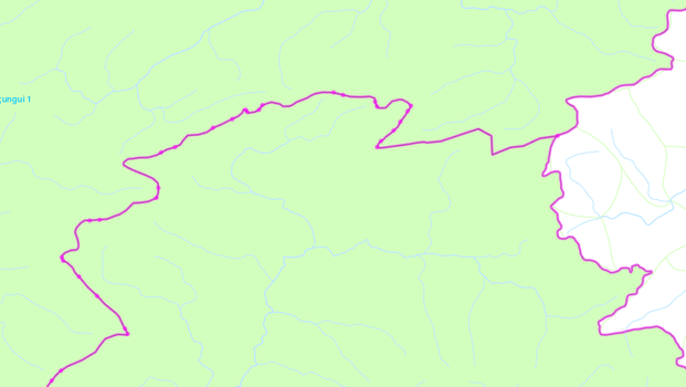

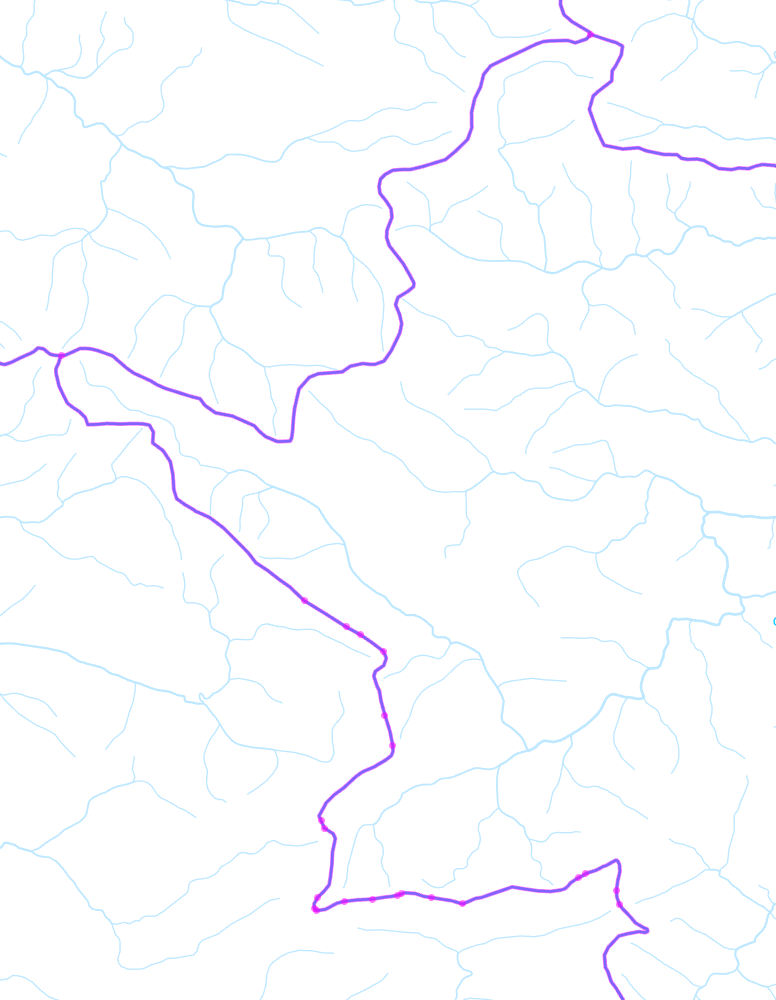

Hello. I am currently using topology-enabled reshape edges tool to fix some drainage basins.
When I select the edges on my polygons, some of them are all nice and cool, the whole edge is a single edge, like the upper one on the image below. But for some reason, other edges appear completely shattered into pieces, like the lower one on the image, with all the pink dots. You can see there is no other polygon for there to be multiple intersection points.
I tried selecting multiple edges and drawing a single line, but the error occurs then. What could be causing this?

Thx for the feedback!  So I now wonder if there are gaps/overlaps in your polygon FC.  Are you able to create a geodatabase topology and add rules "must not have gaps" and "must not have overlaps"?

Hmmm...this is odd.  I wonder if what you're seeing are pseudonodes.  According to the web - "The definition of Pseudo node is "Pseudo nodes occur where a single line connects with itself or where only two Polylines intersect."  Let's try something to confirm.  run the Multipart to Singlepart GP tool in ArcGIS Pro and then apply your Map Topology workflow again.  Do you see the same as before?
jbcypreste
Did the multipart to single part... they are still around lol
It only happens on a few specific edges, specifically between the limits of the major basins. So I guess something must've happened in the past when joining the features from different sources. My org has only recently switched from Map to Pro so there's that too.
I'm using Reshape Feature and Align Features for these cases. Thanks anyway!
jbcypreste
Hey! I just ran "Find Overlaps" GP tool and there were a bunch of tiny thin gaps and overlaps between those features. I'm doing Reshape to fix them. Is there a tool to find all gaps and overlaps and/or to fix them automatically?

I bet that's what's causing your pink nodes.  You could create the GDB topology in a feature dataset and use the Error Inspector to find and correct gaps/overlaps.
jbcypreste
Thanks, it worked! I actually didn't know about gdb dataset topology until now, most here are still used to stacking shapefiles and I only started with pro a few months ago, no this will be very useful in the future.
