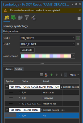

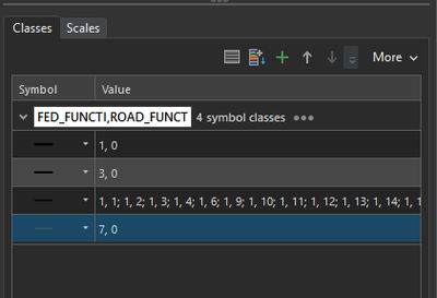

Hello old friends,
In ArcGIS pro 2.3 when i attempt to symbolize using "Unique Values" on a feature class that is joined to table i get the "Requested operation could not be completed".
I get this error regardless if i am symbolizing on one field or two or in a field in the feature class or the table, however when i remove the join guess what?
It works!
Can ArcGIS Pro 2.3 not handle symbolizing when in a join is in place or am i missing something?
Capture 1.jpg - with join.
Capture 2.jpg - w/o join
Other notes:
Data is in a versioned enterprise sql database.

wayfaringrob
Honored Contributor
I'm running into this today with Pro 3.0. It's just a plain old shapefile, symbolized by two fields. I'm able to edit the first three classes that I added some time ago, but unable to change the symbology of a value I added recently. I've tried closing/reopening, copying to a different map, etc.
wayfaringrob
Honored Contributor
Alright - I think I found a solution for at least my case - that first heading that shows the longer field names? That came from the AGO version of the layer from which I imported symbology. The names are truncated in the .shp, obviously, and even though the symbology was referencing the truncated fields, the label of that heading was still showing up with the full names, and this was causing issues. I was unable to move or remove the "7, 0" class, but I could remove the heading and classes from the 3 dots. I then renamed the header with full names to the truncated names and re-added the value. It joined the first header and I am now able to modify the symbology, move it, remove it, etc.
