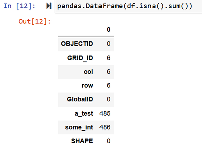

If you're comfortable with python, read your feature class into a DataFrame in, then:
pandas.DataFrame(df.isna().sum())

Oh my gosh, that is so helpful!    I think that will work for us  Thank you!
