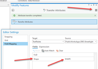

KeithAddison1
In Pro 3.2.2 the shape option no longer shows up in the Field Mapping submenu.  May be because the layers I'm working with are on SDE.
