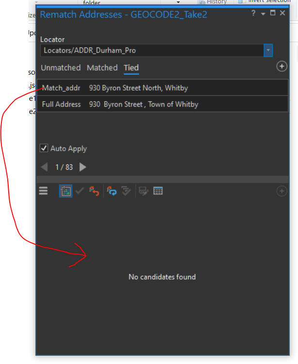

I'm trying to Geocode using ArcGIS Pro 2.8. With my 'Tied' addresses is there a way to get the ties to show up in the candidates window?? For me, the candidates window is just blank:

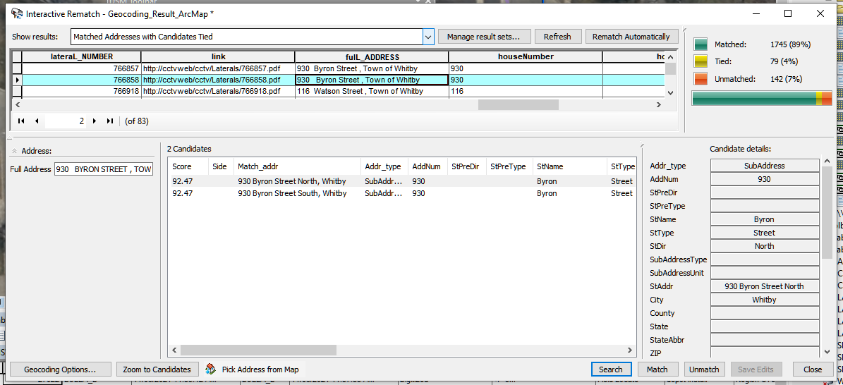

If I use ArcMap 10.4 to Geocode I do see the list of candidates shown:
Am I missing a setting or something in ArcGIS Pro??

Hi @MichaelVolz ,
The World Geocode does not even appear as an option, yet is in my projects Locators folder.
What is your active portal (AGOL or on-premise)? Do you have the World Geocoding Service referenced in the active portal?
I had AGOL as the active portal and the World Geoding Service was registered there so it appears by default. I switched the active portal to an on-premise portal and the World Geoding Service was no longer available by default. This might explain your scenario.

My current portal for all of the above screenshots is:
Brian:
1. Are you using the same locator in ArcMap that you are using in Pro?
2. What are the supported categories that are enabled in the locator properties of the Addr_Durham_Pro locator if it was created with the Create Locator tool?
3. I noticed that the candidates returned in ArcMap have an addr_type of Subaddress, but the input address is just <house number> + <street name> + <city>. Are any candidates returned for '930 Byron Street, Town of Whitby' when enter in the Locate pane search box from your locator or the ArcGIS World Geocoding Service?
4. You would need to check that you have batch geocoding privileges in your organization to use ArcGIS World Geocoding Service, otherwise you would only be able to do geosearch or place finding (not batch). This would explain why you can see it and use it in the Locate pane, but not in any geocoding tools.
Hi @ShanaBritt
It's been ages since I've looked at this, but I'll try to answer your questions.
1. Yes, I was using the same locator in both Pro and ArcMap
2. I have no idea. I created the ADDR_Durham_Pro ages ago. Is there a way to backtrack and find out?
3. No. 930 Byron Street will not geocode, since there needs to be a N or S distinction.
4. I most likely do not have that privelege, so probably why it's not working.
