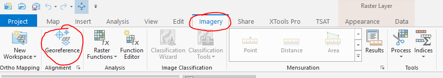

OK, I've figured out the issue here. "Not enabled" means that the ribbon is not open. Unlike ArcMap where if the toolbar is open, it is accessible, in ArcPro you have to open the ribbon every time you want to use any tools from that ribbon, then close the ribbon when you're done with the tool (if there's a better way to leave open like ArcMap please let me know!).
So to get around this, I had to create a hidden step to simply open the Georeference Ribbon, then use the Fit to Display tool.
The Georeference Ribbon is hidden within the Imagery Ribbon. Click to open, then it is "enabled".

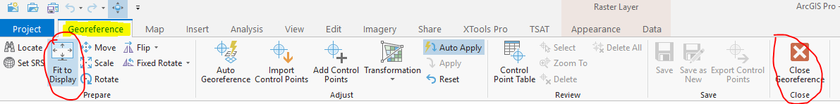

The Georeference Ribbon is open. To move to another tool, you have to Close the ribbon, which disables these tools.

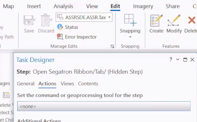

Not sure if something has changed between versions of Pro, but when I attempt to record an action, clicking on Ribbons/Tabs is not recorded. Is this the method you are referring to: Using record to set the command of opening a ribbon? In the GIF I show how no command is recorded when i click on the ribbons, only when I click on a tool.
