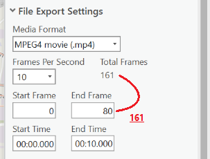

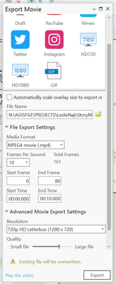

Hello Nathan.  The change in background worked great.  I exported it to a YouTube mp4 file.  But when I play the video back, it stops at 5 seconds and does not complete the route.  I attached my settings in a screen shot below:
NathanShephard
Thanks Catherine!
It looks like you've somehow overridden the frame-count for export.  See how the Total Frames says "161", and the End Frame for the export says "80".  If you change the end frame to 161, you'll be good.  We do allow people to override these values so perhaps it was done accidentally...
Thanks,
-Nathan.
CatherineBradley2
Thank you again Nathan...but I only have 80 frames in my original animation.  Why does it change to 161 when there are only 80 frames?  Sigh...
NathanShephard
Hard to say without an instant replay video of all your interactions with the animation, intended or not.  😉
Changes to some setting values will propagate another change that might not be directly obvious. Hopefully you'll at least come out of this adventure with some things to look for when you get unexpected results. If we can identify things we're doing in the code (or UX) that lead to confusion, we can look to improve them in a future release.
