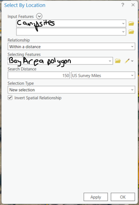

If you have a municipal boundary layer of your area of interest or a point at your location, you can do a select by location of all campsite points within 150 miles of your location, inverse it, then delete those points.
