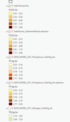

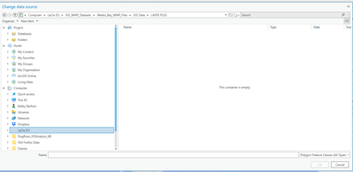

I imported a map into ArcPro that I created using ArcGIS Desktop several years ago. The layers showed up in the Contents Pane, but with red !. I tried to set the data source for the .lyr file, but when I go to where the file is located, it says "This container is empty" and the only option is (Poly Feature Class (All Types). How do I get these layer files to work in ArcPro.

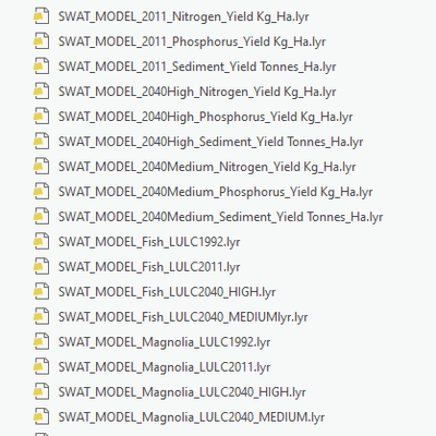

These are my layers I need to re-connect or Set the Data Source for. These are layer files from ArcGIS 10.8. When I try to drag and drop these layer files into a new ArcPro map it gives me the same Red !. Here is a screenshot of the what I get when I try to set the data source. I pretty sure because they are .lyr files (older arc desktop version) and ArcPro layer files are .lyrx. I tried just changing the name and adding the x at the end, but that did not work.

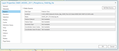

KelleyBarfoot1
Here are the properties from the map project.

Thank you.  The source of the data is from a personal geodatabase it looks like which is not supported in Pro.  Do you have access to ArcMap where you would be able to access that data and convert it to a file geodatabase which could be used in Pro?
