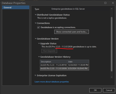

@dgregory_coconino,
The database version can be found in ArcGIS Pro by right clicking on the SDE connection in Catalog and selecting Properties then General > Geodatabase Version.
