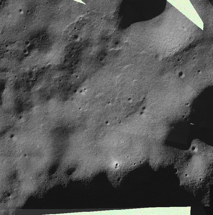

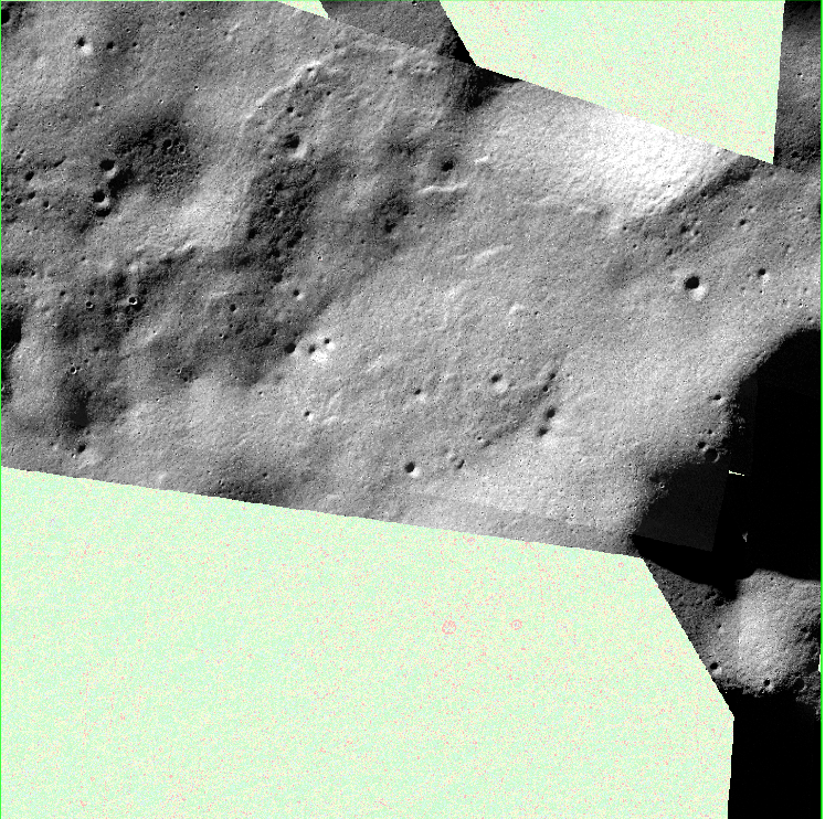

Here is a screenshot of how the mosaic dataset displays:

The other images do not render at higher or lower scales. All 12 images appear in the "footprint" attribute table. Overviews, stats and pyramids have also been built duing the "Add Raster to Mosaic Dataset" process.
Any idea on what's going on here?

I was able to have all raster's displayed after calculating the correct MaxPS (in attribute table) for the rasters that were not displaying. Once calculated, I overwrote the original MaxPS values that were in the attribute table.
More info here: https://resources.arcgis.com/en/help/main/10.2/index.html#/Cell_size_ranges_in_a_mosaic_dataset/009t...
Honestly, as a short cut,  I probably could have gotten away with just choosing one of the other MaxPS for one of the other displayed images.
Hope this helps.
