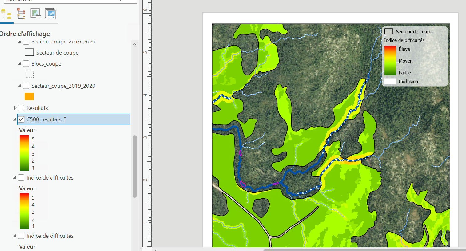

I'm trying to export a layout displaying a raster with a custom stretch color ramp (based on custom statistics and modified min/max). Although everything is fine when viewing in Pro (see exhibit A below)

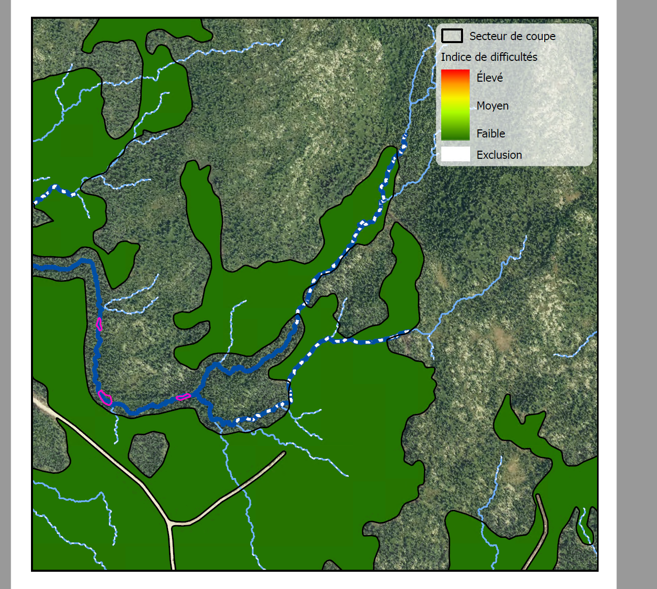

... whenever I try to export it becomes only one color (see exhibit B)???

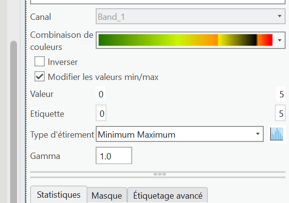

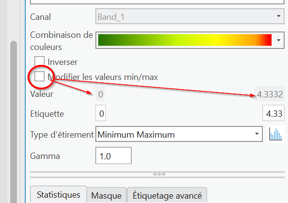

Then, I figured maybe it's the customizing it self. Turns out, if I uncheck the "modify min/max values" box it's working.
But I need those values to be different in order to use the same symbology for multiple rasters that don't have the same value range.

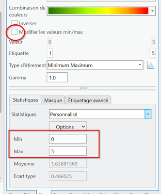

OK, turns out I can answer that myself. If you change the min/max in the statistics window and leave the modify min/max unchecked, it's working.
Anne-MarieDubois
