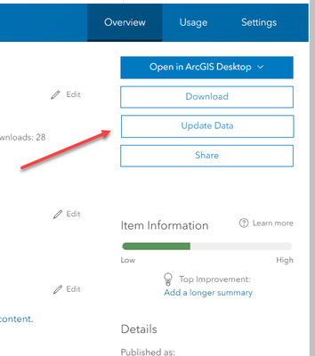

I just republish from Pro using a different name, then rename that tile package so that it can be used to 'Update' the existing tile package.
Then import the updated tiles into the existing service using method 3 from here.
