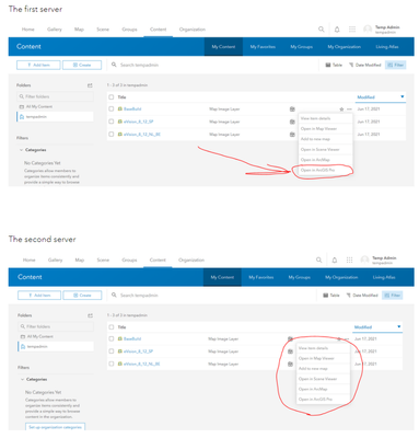

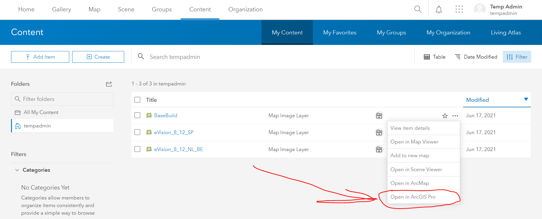

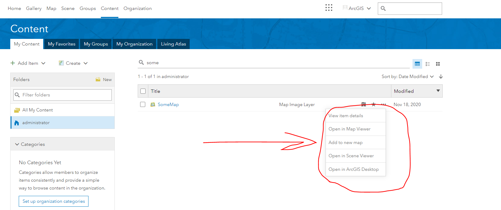

In my current company we have two already deployed ArcGis servers.  One of them provides the "Open in ArcGisPro" option in the list of layers. Unfotunatelly the second one doesn't provide such option. Could you suggest how can I add "Open in ArcGisPro" for the second server, please?
The first server
The second server

I can see "Open in ArcGIS Pro" option in both the screenshots. Did you take both the screenshots from the same Server/Portal by mistake?
Think Location
AlexRepnin
I updated the post. Look at it again, please.
