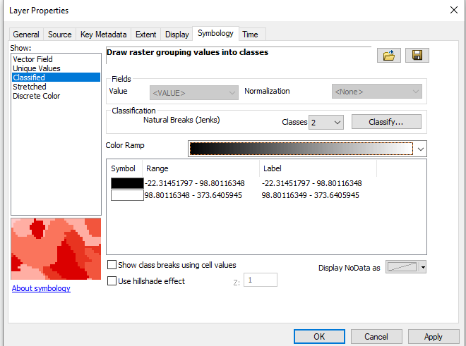

I am trying to symbolize a USGS DEM elevation raster into 2 classes: Values above 100 and values below 100.

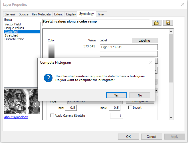

In ArcMap, I have no trouble doing this.  I open the raster properties and click "Classified".  I answer "yes" to the question about computing a histogram:
No problem there.

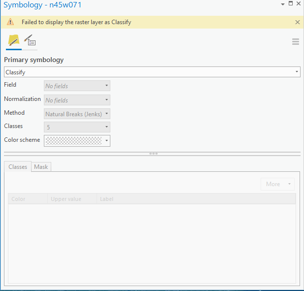

However if I try to do this in ArcPro 2.3.1 on the same exact raster, it won't work
What am I doing wrong?
