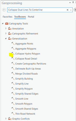

Does the "Collapse Dual Lines To Centerline (Cartography tool)" not exist in ArcGIS Pro 3.3? I didn't see it in the list of tools that are not available in ArcGIS Pro and I found it in the tool reference but not within ArcGIS Pro. It also doesn't come up in with ArcPy. Am I missing something?

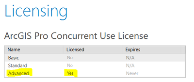

MonicaMoreno-Espinoza1
Hmm, I should have the advanced license.
Thank you!! Looks like this is the issue. Did not realize I wasn't on 3.3 release. I will submit a request to IT.
