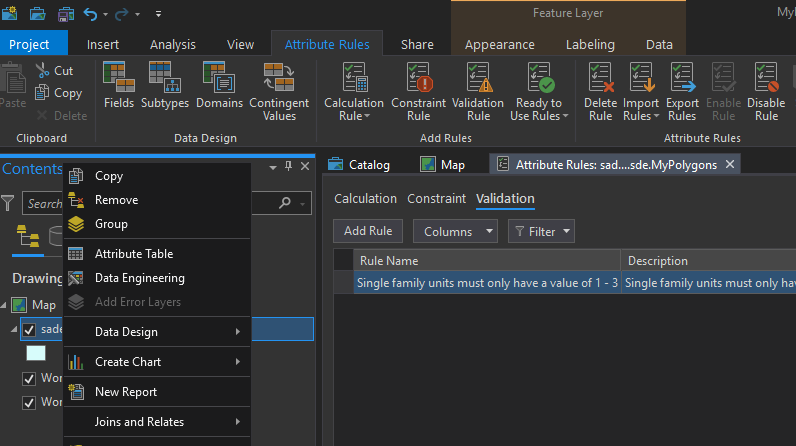

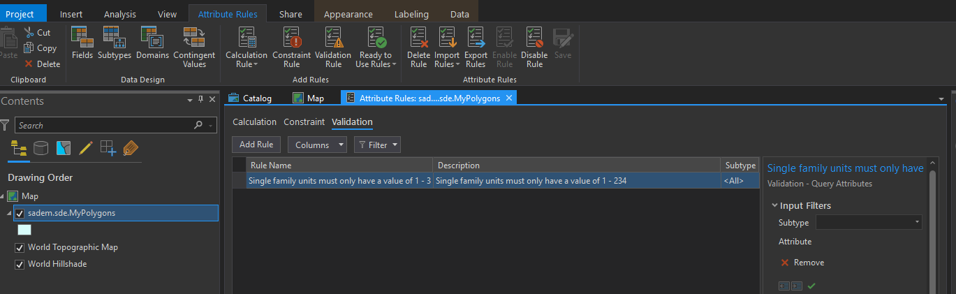

Hi All,
I have a feature class that has 1 of the data-reviewer "Ready to use rules", the feature class resides in an Enterprise geodatabase, branch versioned, database connection is using data owner account. The validation feature classes are all created and also branch version enabled.
I am trying to add the error layers to Pro map, but the option is disabled. Any idea what am I missing?
Regards
Ihab

thanks heaps @SamPienaar , it is now working
the steps that Sam pointed out to get the error inspector working against feature service:
* ensure you are accessing the database through branch version connection
* ensure your datasets are version enabled
* manually add the datasets and the error layers into Pro map
* publish feature service and ensure "Validation" capability is enabled
* from Pro catalog, browse to Portal, then to the published feature service, and add only the sub layer that has attribute rules
* from the Pro map contents panel, right click the sub layer, choose "Add Error Layers"
now you can validate the rules against feature service from the "Error Inspector" panel..
