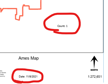

@DominicRobergeIADOT , this works great! Thank you! However, one thing it is not doing is including my dynamic text that I have in the layout. I have a date/time exported and a record count. Any idea how to get the print command to include those?
DominicRobergeIADOT
hummm I am not sure. it's working for me (see image below). Can you try to add a new dynamic txt for the count just for fun.
LindaSlattery
Thanks! That worked!!! Much appreciated!
