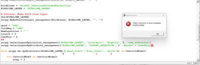

JRR
Neither of these lines work.

JRR
I tried with no success.   Sorry to be so late in responding.. traveling.
Sent the code and a sample data set.
