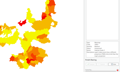

Hi,
I'm trying to publish a FGDB raster to my Portal and it doesn't seem to be doing much. It says Queuing for the last 4 hours. Anyone any ideas?
I've had no problem publishing vector data but no luck with rasters yet.
sxw_eaglegis
Hi Rachel - Are there any other jobs in the queue? If you click on the Jobs button. You may need to clear out an old job in the queue or there could be something up with the publishing service.
sxw_eaglegis
RachelS
Thanks for that.
There was indeed another job that was running for days containing 6 rasters. I deleted that and was able to publish my single raster. I may just publish them all individually.
