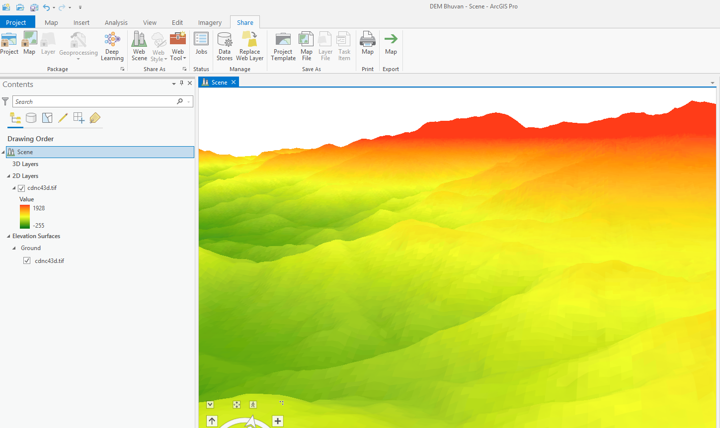

I have a few tiles of elevation information (DEM) in .tiff format. I could load them up in ArcPro and generate elevation surfaces, as illustrated in the picture attached.
But when I publish them to ArcGIS Enterprise, the portal scene only shows a flat surface, without any elevation. The layer TOC shows the uploaded DEM in the ground layer group.
What could be the possible reason?
MervynLotter
MVP Regular Contributor
You will need to create a tile web elevation layer. Follow the steps is this help link Share a tile package—ArcGIS Pro | Documentation
