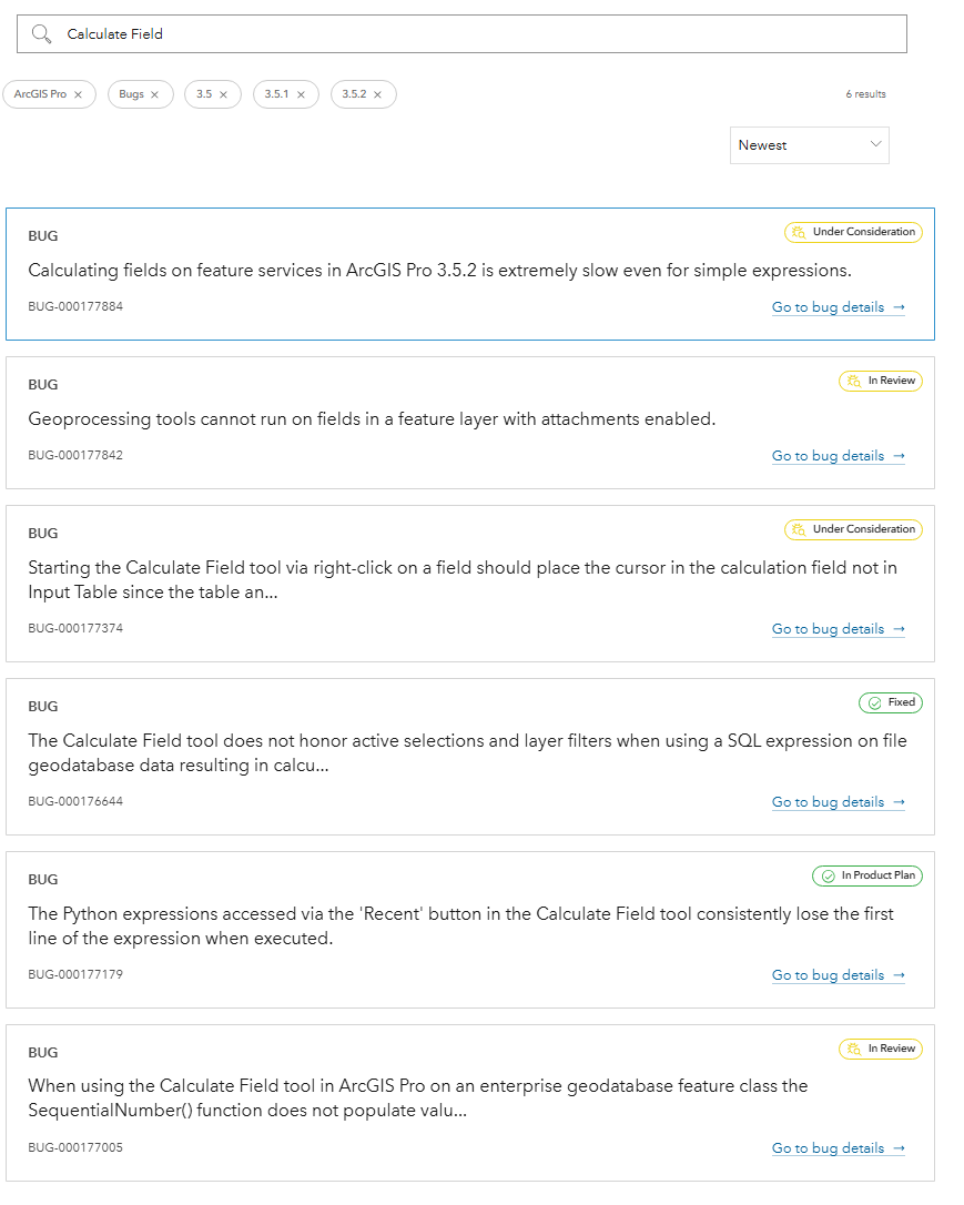

For those following along at home:
https://support.esri.com/en-us/search?s=Newest&product=arcgis+pro&cardtype=support_bug_articles&vers...

If the defect in the screenshot is related to the issue than it is "calculating fields on feature services."

Open Attribute Table of  FC in FGDB = Feature Class in File Geodatabase
As they say 'All things are related' but I'm not sure how the other listed issues in Pro 3.5.x are related to this new issue. They may not be. In my opinion there is enough walking & quacking to make me see ducks.
