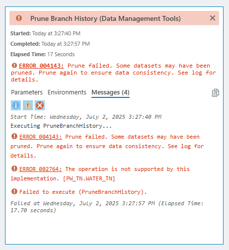

We are using a Trace Network which requires us to use branch versioning. One of our layers is updated each night with new information so the layer is growing very quickly, and we are beginning to see performance issues. We found that in the latest ArcGIS Pro release there is a new tool called Prune Branch History. When we run it, we get the following error. I cannot find any useful information online as to why this would be. We are using a branch version connection to the feature data set, we are disconnecting all users from the database before running.

@LRoberts_RDM - The tool currently doesn’t support the Trace Network. We have plans to extend it to support Trace Network and Parcel Fabric datasets in a future release.
