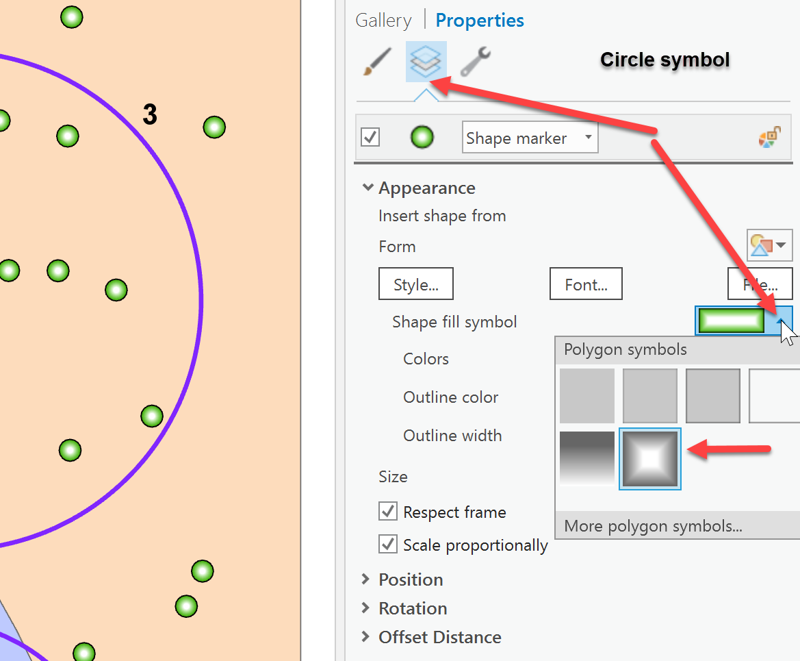

you could spend the day trying to get it exactly... but the polygon fill style for a circle symbol and a bit of playing around will get you close

Awesome Dan! Learning curve switching over to pro but a lot easier with people like you help out. Really appreciate adding the graphic too, made it quick to implement. Thanks for your time.
