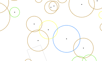

Hi everyone, I have a question about a specific use of proportional symbology with point shapefile. I have data representing trees with attributes of crown radius (in meters) and vitality (values 1-5) and I need to display the trees as circles with the crown radius so that the outline color changes with the vitality attribute (see image).
If I use a proportional symbology for the crowns, the only way I can get it to look like I need is to copy the layer five times and use Definition Query to symbolise each value with different outline color. Vary symbology by attribute doesn't work as it changes only the color of the filling. And if I use Unique values symbology, the size of circles is changeable, but can only be used if I want to display the data in one scale of map and calculate the proper size.
Is there any easier way to combine these symbology properties (as I know it is possible in qgis), or do I have to continue with using Definition Query?

ZuzanaFialova
Hi,
thanks for the reply. At first glance this looks like it could be a good workaround and I might try it, but I'm not entirely sure it's usable for me.
I would prefer, if I didn't need to create several layers, since sometimes I need to create several maps using different attributes with several values (e.g. vitality, age, taxon,...) and it could easily become a hundred new layers. Also I might have the need to edit some values and that would mean to run this every time I do so.
So it would seem that for now one layer displayed several times using definition query is better for me. As it displays any changes immediately.
