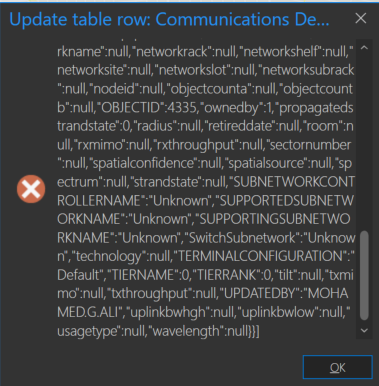

I always do this kind of filter using profile variable $datastore. I want only to get the field room from this table, but when printing the results all fields are there
var test="{4EC98101-67C4-44FC-8BF5-C7DF9393AB73}"
var deviceClass = FeatureSetByName($datastore, "CommunicationsJunctionObject");
var devicesRows = Filter(deviceClass, "GLOBALID = @test");
return{"errorMessage":"FeatureSetByAssociation: "+first(devicesRows)};
this screen of the output

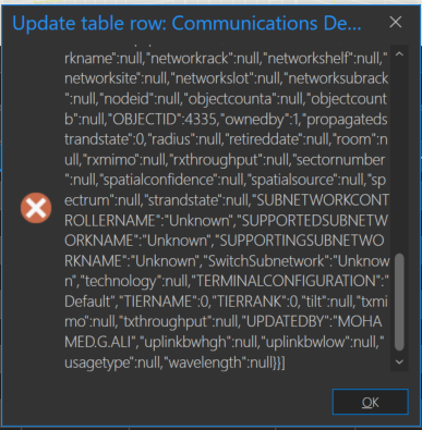

var deviceClass = FeatureSetByName($datastore, "CommunicationsJunctionObject",['room'],false);
the second output
You return the whole feature, so every field is printed. Instead, return only a specific field:

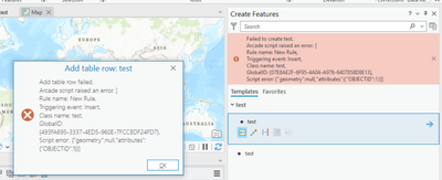

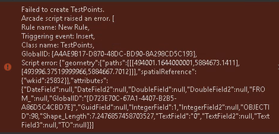

Ah, I see now that I misunderstood your second question.
I see this behavior in a file gdb. While the Console() command ouputs the right message (empty geometry and only one field [plut OBJECTID]), the error message prints the complete feature, although I didn't load the geometry and the other fields.
var fs = FeatureSetByName($datastore, "TestLines", ["IntegerField"], false);
Console(First(fs))
return {errorMessage: Text(First(fs))}
In an Enterprise GDB, it works as expected:

Regarding my second question, I know how to print a specific field from the feature my question was about, I had read in the documentation that specifying specific fields to feature class or table is making performance faster, so I thought the object returned from this line should only contain room field.
Console(First(fs))

HusseinNasser2
@JohannesLindner  Can you try the filegdb case with Pro 3.1 Beta if you have access?
We have a known issue where Arcade might sometime fetch all the fields even a subset is provided.
Mohamed_Gamal
Unfortunately, I don't have access to Pro 3.1 Beta version.
HusseinNasser2
No worries, I confirmed this is fixed in Pro 3.1.
