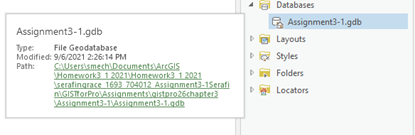

I have an issue grading student projects. To verify they have built their project correctly, I have them submit a zipped copy of their complete folder including the geodatabase, aprx, etc. This was my standard practice Prior to ArcGIS PRO 2.6. However, now that we have upgraded to ArcGIS Pro 2.8, when I open the project on my computer the links to the data are broken, even though the geodatabase link in the catalog points to the correct location.

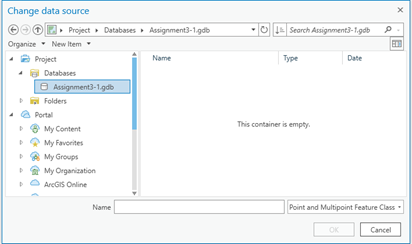

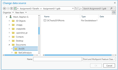

The geodatabase appears empty until I navigate to the actual location (rather than the link found in the project). This is interesting given that it really is the same geodatabase.

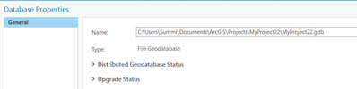

If you right mouse click on the database in the Databases folder, and select Properties. Whats the path in the "name" field? Does that match the correct location?

@David_Brooks  Yes, the directory is accurate (the first image was intended to show this).
