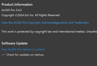

ShaneTMF
For me this was upgrading to 3.4.2. I am also experiencing the same issue. Any fixes yet? Thanks!
