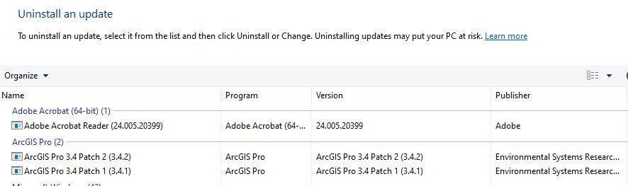

Yes there is.  Go to your Control Panel and under Programs, click Uninstall a program.  In the Uninstall or change a program panel, top left, click installed updates.  In the Uninstall an update under ArcGIS Pro, you'll see the patch updates.  Right click ArcGIS Pro 3.4 Patch 2 (3.4.2) and select uninstall.  Then do the same for ArcGIS Pro 3.4 Patch 1 (3.4.1).  Now your ArcGIS Pro is at 3.4.0.
Woosh_AP
Hi @Robert_LeClair . Thanks for this. Unfortunately, under "View installed updates" I only see Windows updates. Is there another method to roll back or can I only uninstall the entire program and reinstall it?
Robert_LeClair
Esri Esteemed Contributor

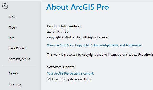

Interesting.  So I do see 3.4.2 and 3.4.1 updates in my panel.  I guess the question is now, is do you have the patches installed to begin with?  You can go to the Project tab and click About to see what's installed.uninstall1.JPGuninstall2.JPG
