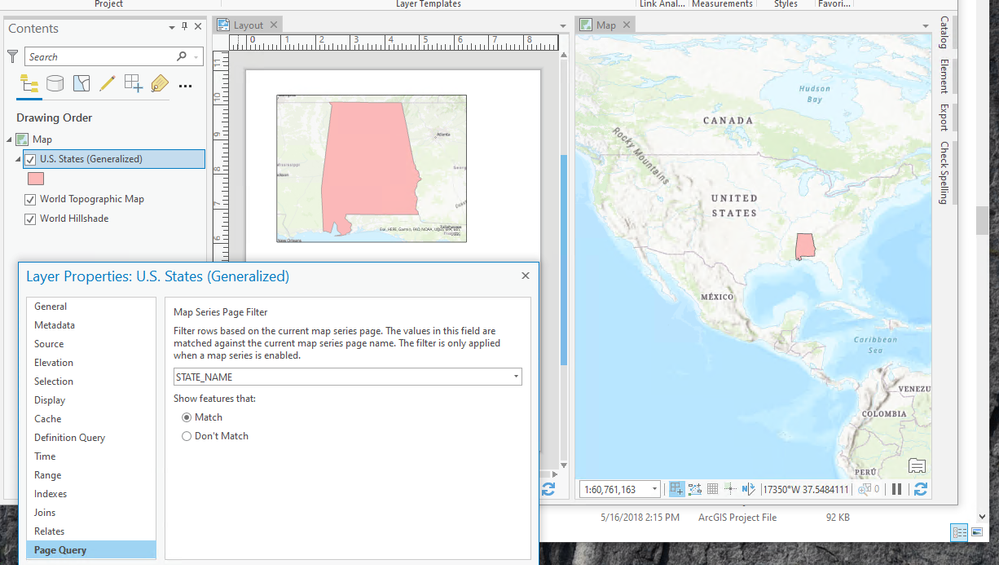

Your description of the issue sounds like there may be a Page Query set on your lot layer. For example, in the screenshot below I have a map series based on the layer U.S. States (Generalized). There is also a Map Series Page Filter (Page Query) set on this layer.
Notice that in the map view only 1 state is shown. This is expected behavior since the Page Query is a layer property and the current state of this property (set by the current page of the map series) is set for any instance of this layer.  If you wish to see all the features of the index layer you will need to either remove the Page Query from the index layer or create a separate layer (a copy of the index without the Page Query). All this is assuming that you have set a Page Query.
I'm a bit concerned with your comment "Since I uploaded arcgis pro 2.7.0, I have this issue".  Does that mean that you were seeing different behavior in a previous release? If that is the case more investigation is warranted.
