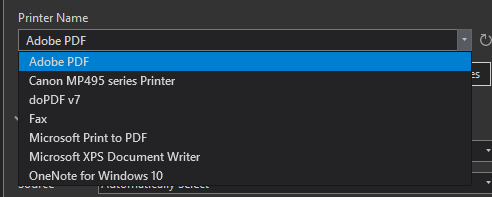

Not sure if it's a bug or if it's related to the print engine your using to create the PDF. In my case I managed to print it in black and white only with the Adobe PDF virtual printer driver. doPDF and MS PDF seem to ignore the Print in black and white option (although I use an old version of doPDF, have to try a newer one).

So Microsoft Print to PDF doesn't support black and white printing. It's a limitation of the printer service. Ideally you shouldn't be able to check that if the printer doesn't support black and white printing. There's a bug for that you can follow here: https://support.esri.com/en/bugs/nimbus/QlVHLTAwMDEyOTY2OQ==
