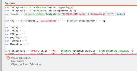

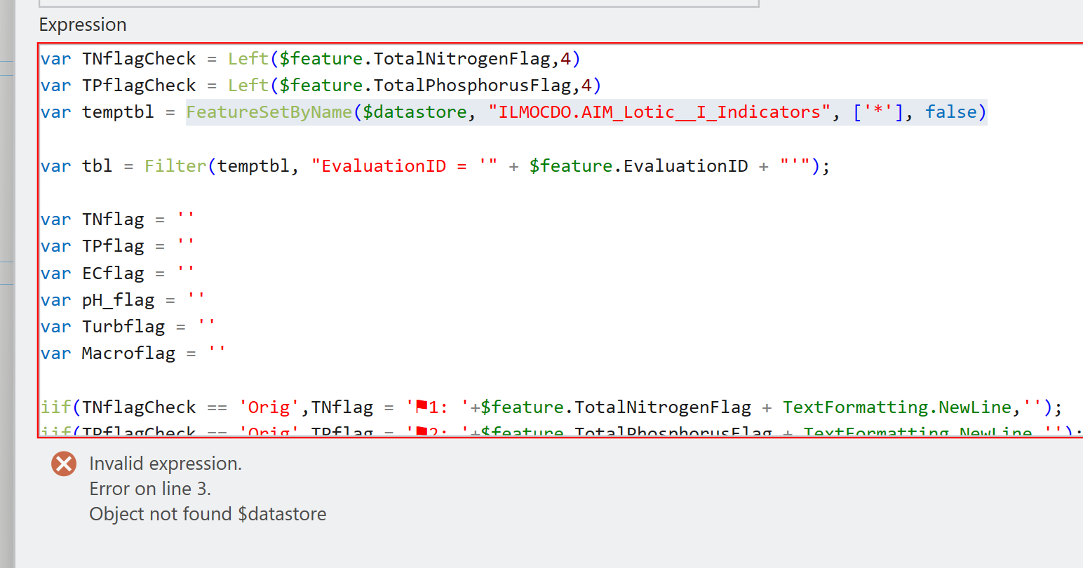

I think this was when we went to Pro 3.5.5 all of a sudden all our Arcade using $datastore in layouts in dynamic text broke.  We have tons of these.
We are getting
Object not found $datastore
on code that has worked for over a year at least.
Simple code here that calls to SDE.  Tried with and without SDE prefix etc.  Again this all worked for years.
FeatureSetByName($datastore, "I_Indicators", ['*'], false)
We had it nested under Filter but pulled it out for testing.  I do not see how datastore can not be valid?
Not finding anything at all out there on this.  Tried $map and does not work which I get.  But why is datastore suddenly gone?
Appreciated the help all our production stuff is now down so we are desperate.
thanks

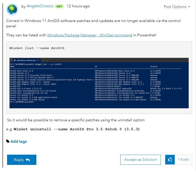

One way to test if 3.5.5 "broke" the $datastore item is to uninstall 3.5.5 and revert back to 3.5.4 and then retest.
For Windows 10, you can uninstall the ArcGIS Pro 3.5.5 service pack by going to Control Panel->Uninstall a program->(top left) View installed updates->then click the ArcGIS Pro Patch 1 (3.5.5) and uninstall.
For Windows 11, MS made it a bit more difficult, see image below:

Okay - digging deeper, I believe this is BUG-000182720 - "Arcade expressions using FeatureSetByName($datastore, ...) fail to validate in layout dynamic texts in ArcGIS Pro, returning the error “Object not found $datastore.”  It's currently under review.  The issue is not reproducible in ArcGIS Pro 3.4 and earlier but 3.5 and above.

The Arcade Layout profile (https://developers.arcgis.com/arcade/profiles/layout/) does not support the $datastore profile variable or the Data Access function bundle. Validation was updated at the 3.5 release to more strictly enforce profiles and this case that previously had been undocumented and unsupported behavior stopped working. Furthermore, in ArcGIS Pro 3.6 the code editor now includes profile-specific code hints to indicate when variables outside the scope of the profile are in use. We understand from your viewpoint that this is a regression in functionality, but execution of such scripts was accidental and as mentioned above unsupported and undocumented. Including support for feature set functions and profile variables such as $datastore may be considered for a future enhancement, but feature set functions are generally not included in drawing profiles due to performance impact. An alternative approach would be to perform the necessary computation in a calculation attribute rule and consume the calculated field.
