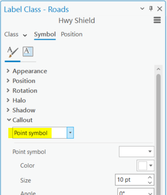

In order to create a road shield or similar similar label with a custom font marker behind the label, start by adding a Point symbol callout to the Symbol.
Next, click the Point symbol menu and select Format point symbol...

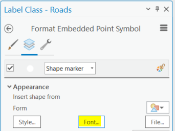

In the Formatted Embedded Point Symbol pane, open the Layers tab and click the Font... button.

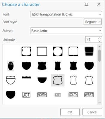

The Choose a character dialog box will open - locate your font and select the desired road shield symbol.

KeithAddison1
Thanks, got it working.  Took forever to get the options right so it looked good.  Somehow it's more confusing than the way ArcMap did it.
