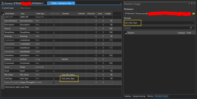

Thanks Kory; hopefully it's just a 2014 SQL Server issue. We are wanting to get off SQL 2014 but are waiting for a wider SQL cluster upgrade. Here's how it looks for me in ArcGIS Pro 2.6.3. I renamed the domain over a week ago and it's still not picking up the change using the Domain Usage tool.
