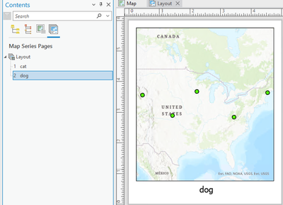

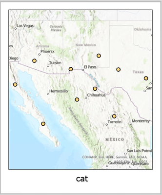

JesseWickizer
Create a spatial Map Series where each page is the extent of each animal. If the animal distributions are unique polygons for each animal, that feature layer would be the index layer for your map series.
If the animal distributions contain multiple polygons, lines, or points for each animal then use the Dissolve tool to combine the animal distributions into single features per animal. Use the dissolved layer as the index layer for the map series.
Then you can add a page query to the original feature class to only draw the animals from the feature class that are the focus of each page.
MartijnvanOene
Hi Jesse,
Thx for your response. It's a creative way of thinking. The only problem in my case is that the extend for each map should always be my project area. Not the extend of the distribution of the animal.
But I will keep this workflow in mind, cause I think it will help me in other cases 🙂
Best regards,
Martijn
JesseWickizer
Using a spatial map series would allow you to use page queries that would change the data that's drawn even though the extents would be the same for each map.
If you want the extent to be the same project area, you could create an index layer that is the same extent or same point duplicated 100 times and assigned different names for each animal. Once the index features are duplicated you could quickly assign the unique names by joining to a table with the unique animal names by objectid and populating the index layer names from that.
