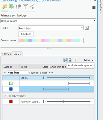

You can do this using Alternate Symbols.
Choose Unique Values
Click the Scale Tab
Select your symbol and then add alternate symbols to display at the specified scale.
